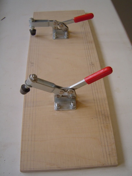

Some years ago I made this simple jig up to radius my braces. It will handle anything up to 25mm thick. I just traced the radius I wanted on the edge rough cut it on the bandsaw then sanded to exact profile in the dish. This has the advantage that the radius on the jig, and on your braces matches the radius of your dish rather than a generic available 15/25 jig. I did one side 25' and the other 15'. The clamps were bolted on, they have to be unbolted and turned for the other radius, as a 'temporary' method. I must get round to a 'permanent' fix sometime .
The radius is cut on the table router then the braces are just touched up in the radius dish. I usually radius enough for a couple of guitars at a time.
ColinColin S39063.4090162037

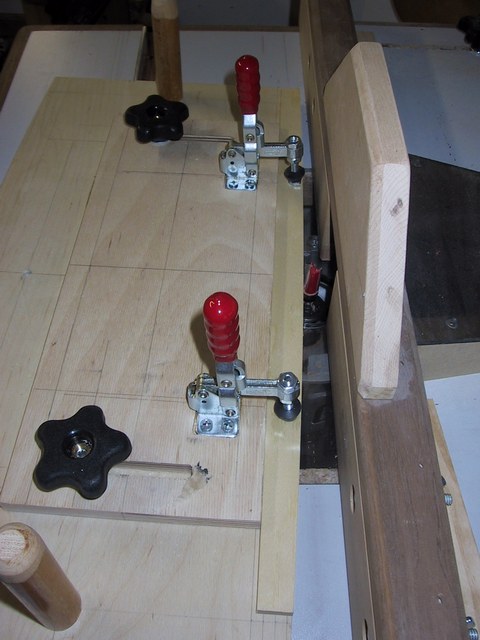

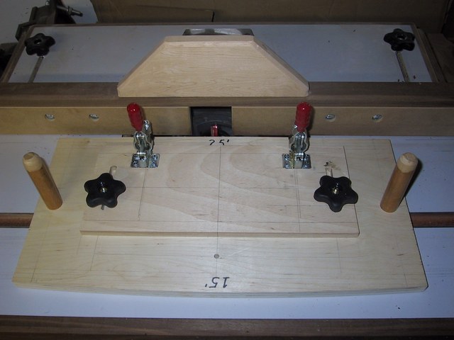

Thanks to Bob Cefalu's jig that he listed in the "Jigs & Techniques" section, I was able to produce the jig pictured below. Before he donned his cape and became the "Zootman", Bob was an excellent guitarmaker and a master woodworker. You should see the fine furniture he has built!
The first pic shows the jig designed for a router table. It is capable of milling both 15' and 25' radii. I use a pattern bit...the bearing rides on the radius portion of the jig and the cutters slice the brace to conform to the radius. You need to carefully climb cut first to prevent tearout.
The second pic shows it in action.
Once the brace comes off the jig I take a few swipes on the sanding dish to complete the spherical radius profile. Total time for each brace...under 2 minutes.

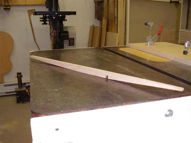

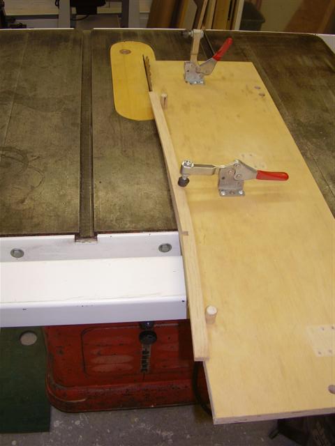

Since we're showing off jigs
Here's mine, based on the same idea as Tracy's and Sylvan's, I use the mitre slot on the table saw with a board to hold the brace. Bend the brace and saw away. A couple of swipes on the dish (e'tout JJ) and it's ready to glue. Quick and easy. I also use this jig for cutting the taper on my fretboards, just pull the 1/2" dowels and it's ready.
This is a scrap piece for demo purposes.

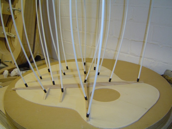

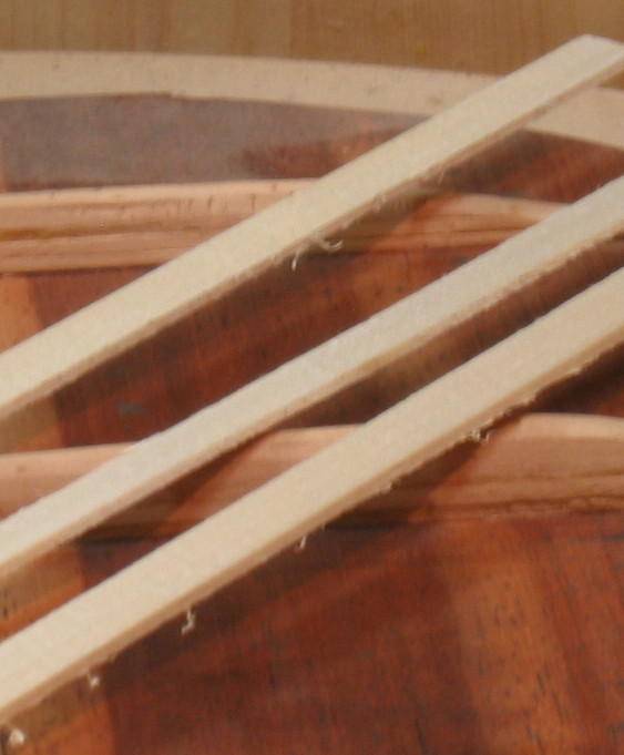

I like to use"leaf spring" braces. I rip the brace wood into strips .090 then run through my router table set up with a 3/16" spiral bit against a fence to plane the strips to 0.06" and smooth. Then use Go-bar to set braces on top or back plate pressing into the concave dish. the leaf springs are really easy to use and are laminated into a curve matching the work dish. So simple I can do it. See pic.
Greg
PostPosted: Tue Dec 12, 2006 4:28 pm
Posts: 376
First name: Greg
Last Name: Harrington
Hesh, The strips line up as though quarter sawn. In fact my brace wood is quarter sawn. It is a bit fiddly to get the strips but I like they way they laminate. the flat strips bend and as each is layered the glue lets the leaves slide and conform to the layer below. I have used strips from .060 to about 0.10. The lattter takes 3 to make just shy of 3/8". The idea is not mine. I stole the concept from Fred Carlson's talk on building stunning harp sympatars of extrordinary workmanship.
Greg
